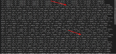

As you can see below this csv file being grabbed from the internet is formatted weird... I converted it to JSON to view better.. As you can see it lists field 1 and then all the values, then field 2 and all the values...
How do I write this to a Feature Layer in Python?  Not sure how to parse through this format to create a Feature from the XY fields.  Do I need to read it differently so it reads like a table with rows?

I'd suggest reading it into a Pandas dataframe.
Could use just Pandas or could use ArcGIS Spatially Enabled Data Frame.
https://developers.arcgis.com/python/guide/introduction-to-the-spatially-enabled-dataframe/
Pandas has lots of good tools for working with tables.
https://pandas.pydata.org/docs/reference/api/pandas.DataFrame.transpose.html
