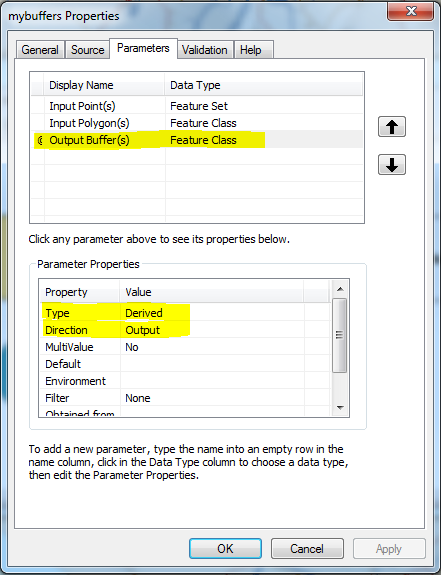

Mybuffers script tool parameters settings (for the output parameter):
Mybuffers output parameter settings
It's like the copy features tool is not getting the data from the script tool even though I've used countless different versions of the SetParameterAsText() and read as much as I can take of the official help. Perhaps there is some good hearted soul willing to look over my code to help me see where I'm going wrong because I'm stuck and getting really annoyed at this

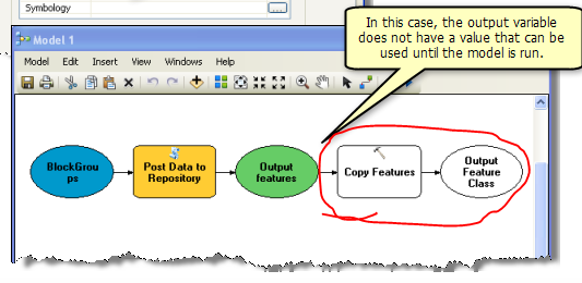

UPDATE 23.10.2017:
I've been relying on the official help in the link below, chapter heading "Derived output that does not modify an input parameter". I have now tested setting up exactly the same example with the post data to repository script tool and the copy features section of the model fails in the exact same way i.e. "input value required", the second tool in the chain does not run.
Setting script tool parameters—Help | ArcGIS Desktop

I Do not know if you are still searching for the answer, but in mubuffer properties window, i see the properties
type: derived
Direction : output
Obtained from : blank
may be you can try setting
Obtained from : Feature Set . i.e input
derived output is obtained from input.

Thanks for the input but unfortunately it is not the answer. In the chapter Setting script tool parameters there is a section called "Derived output that does not modify an input parameter". There it specifically states that this parameter "Obtained from" should be empty (see snapshot below).
