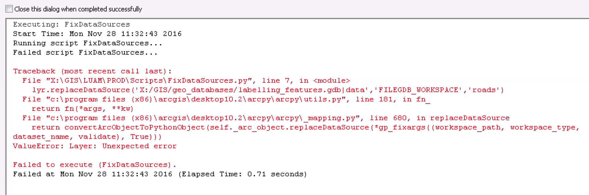

Good day everyone,
I am playing around with the following code to fix broken data sources for file gedatabases. There's something I am getting wrong in it and I am getting the following error messages displayed. If anyone can point out what I'm doing wrong I would greatly appreciate it.
Thanks very much,
Chris

Just a guess, without looking at it in detail a couple observations....
  • do you need to save the mxd before you delete it?
  • why is there a pipe ( |  )  in your argument?

ChrisHolmes
Hi Rebecca,
1. I added in mxd.save, makes no difference to the error.
2. The pipe, I believe indicates that 'data' is a feature dataset in the file geodatabase. I have used it successfully in other scripts, but not sure if it works for this instance?
Hopefully this helps provide a bit more info.
thanks
MitchHolley1
MVP Alum
This path doesn't seem right to me:
X:/GIS/geo_databases/labelling_features.gdb|data
Do you mean to put '/' instead of '|'?
X:/GIS/geo_databases/labelling_features.gdb/data
ChrisHolmes
In the link provided by Rebecca: http://desktop.arcgis.com/en/arcmap/10.3/analyze/arcpy-mapping/updatingandfixingdatasources.htm#ESRI...
I read:
Do not include the names of geodatabase feature datasets in the workspace path. Feature datasets are part of the workspace. If a feature class, for example, is moved from being a stand-alone feature class into a geodatabase feature dataset, a map document will still open without the layer being broken.
So I removed the reference to the feature datasets in each workspace "|data".
The script works now, but it doesn't do anything. lol
I'll have to recheck the parameters I'm using.
ChrisHolmes
I figured it out. I needed to add arcpy.RefreshTOC(). duh. I'll give the correct answer to Rebecca as she got me onto the path of getting this working. Funny that I had previously looked at that link just didn't see the item about the feature datasets. Thanks also for your suggestions Mitch.
