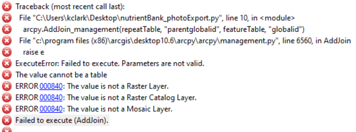

I am attempting to automate a process of exporting photos from a Survey123 geodatabase and give the output a custom filename, modified from the general script for exporting photos provided by Esri. Here is what I have so far. I am trying to join the Feature Layer, image_repeat table and image_repeat__ATTACH table before exporting the photos so that I can use fields that are in the feature class attribute table in the output file names.
import arcpy
from arcpy import da
import os
featureTable = arcpy.GetParameterAsText(0) # the Feature layer
repeatTable = arcpy.GetParameterAsText(1) # the image_repeat table
attachTable = arcpy.GetParameterAsText(2) # the image_repeat__ATTACH table
fileLocation = arcpy.GetParameterAsText(3) # Output folder location for the photos
arcpy.AddJoin_management(repeatTable, "parentglobalid", featureTable, "globalid")
arcpy.AddJoin_management(repeatTable, "Nutrient_Bank_Monitoring.globalid", attachTable, "REL_GLOBALID")
with da.SearchCursor(repeatTable, ['DATA', 'ATT_NAME', 'ATTACHMENTID', 'site', 'plot']) as cursor:
    for item in cursor:
        attachment = item[0] # blob data type
        site = str(item[3])
        plotNum = str(item[4])
        filenum = "ATT" + str(item[2]) + "_" # i.e. ATT531_
        filename = site + "_Plot" + plotNum + "_" + filenum + str(item[1]) #i.e. miyagi_creek_Plot6_ATT531_plot_image-20200324-143302.jpg
        open(fileLocation + os.sep + filename, 'wb').write(attachment.tobytes())
        del item
        del filenum
        del filename
        del attachment
However, I get the following error message - "The value cannot be a table":
I have no problem doing the joins manually in ArcMap, so I'm unclear why it won't work in the script. Is it possible to do what I'm trying to do?

Hi, the problem is you cant apply a join to a dataset, it must be a layer.
arcpy.MakeFeatureLayer(in_features, out_layer)
arcpy.MakeFeatureLayer(repeatTable, "repeatTable_lyr")
then swap out your join repeatable for the layer, "repeatTable_lyr" will exist in the memory workspace or a workspace you specify, you can also of course assign it to a variable.
https://pro.arcgis.com/en/pro-app/tool-reference/data-management/make-feature-layer.htm

Hi David, thanks for your response.
I had to use the makeTableView function because I am working with a table rather than a layer:
repeatLayer = arcpy.MakeTableView_management(repeatTable, "repeatTable_lyr")
However, then I run into this error, 'NoneType' object has no attribute 'tobytes'
So I guess you can't use that function on a table view? If so, how can I access that information to be able to export the photo and assign it a custom file name?

A few print statements will give you a better idea. has that DATA column got any missing values or nulls? that would throw an exception.  If so use a bit of logic such as if type(attachment)… do this or a try Except block with a continue.

You're right, I used an IF statement and confirmed that all of the attributes for the DATA column are None type. The script runs successfully with this IF statement but just returns "No Attachment data" for all rows.
with da.SearchCursor(repeatLayer, ['plot_image_repeat__ATTACH.DATA', 'plot_image_repeat__ATTACH.ATT_NAME', 'plot_image_repeat__ATTACH.ATTACHMENTID', 'Nutrient_Bank_Monitoring.site', 'Nutrient_Bank_Monitoring.plot']) as cursor:

So, something must be going wrong with the join. (again, this issue does not occur when I do the joins manually). Any ideas?

You may have to persist the join by saving into into memory or scratch, if it was me I would save it as an output for the moment and inspect it manually to see what it looks like.

Turns out there was indeed something wrong with the join, I was referencing the wrong 'globalid' in the second join. Specifically, I had the globalid of the feature layer ("Nutrient_Bank_Monitoring.globalid") rather than the repeat table ("plot_image_repeat.globalid")
Here is my full script that works, just in case it might help someone else who comes across this thread:
