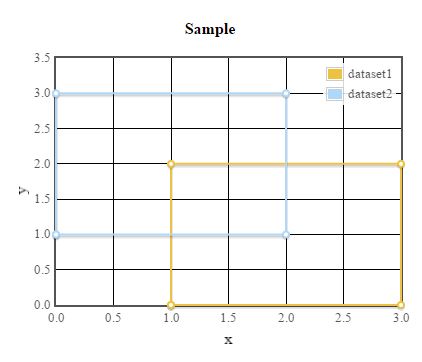

I want to calculate the intersection point of two polygon, the polygons are illustrate in picture. The picture clearly show that there are two points
of intersections.
I have write some code, but there is problem init, it's calculate more than two intersection point. Blow is my code...

Hi,to answer our original question. The extra intersection points are caused by the code which checks for intersection of endless lines. The lines extent to both sides into infinity. To get the right intersections you should check if the resulting points are in the "domains" of the input lines. I'm sure there is an easier way to do this, but see below how I did this.

Yes it's works, It's true only for the case of both polygons have same no of points, other wise it's index is out of bound problem...
