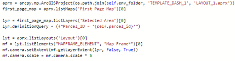

Hi, I think the issue is when you define mf variable
it should be
mf = lyt.listElements("MAPFRAME_ELEMENT""Map Frame*")[0]
below is a glimpse of my code, which usually works for me
AlexanderDaniel_Pratama_0-1708689069501.pngAlexanderDaniel_Pratama_0-1708689069501.png
Don't forget to delete variable aprx and new aprx using del
Hopefully it helps you

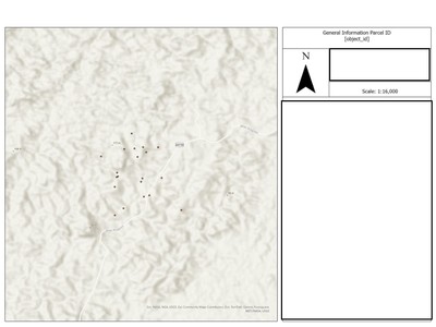

Actually I ran your code several times, and it perfectly works. But I modified the map_frame string as MAPFRAME_ELEMENT""Map Frame* as I suggest.
You can see the difference of this two images below
AlexanderDaniel_Pratama_0-1709088317927.pngAlexanderDaniel_Pratama_0-1709088317927.png scale 6000 with mf.camera.scale * 1.15
AlexanderDaniel_Pratama_1-1709088346587.pngAlexanderDaniel_Pratama_1-1709088346587.pngscale 16000 with mf.camera.scale * 3
