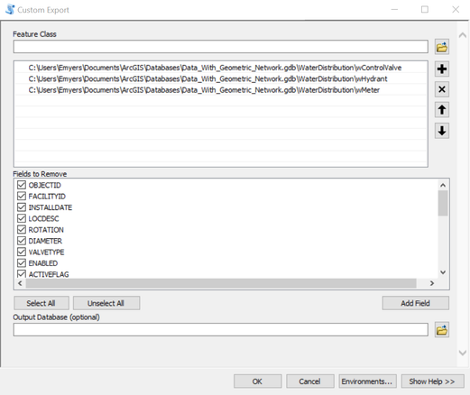

I managed to get the tool to stop the file path error but now it only lists the fields from first feature class (wControlValve).  When I remove that one, it lists the fields from the wHydrants.
Right now my tool looks like this:

I got my code working so far with no errors, and my field list updates properly when I add or remove feature classes, but now I have a new problem.
When I press the "Select All" or "Unselect All" buttons, they don't to do anything, and if I click anywhere (even in another application), all of the boxes are re-check themselves.
I suspect it is because of the updateParameters section of the tool Validator, but I can't wrap my head around the logic the tool is using.  No matter what my order of indentation is in the code it always wants to refresh the list.
