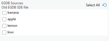

For a PYT, setting a multivalue string parameter will give you this:
        param1 = arcpy.Parameter(displayName=("EGDB Sources:\n"
                                     "Old EGDB SDE file"),
                        name="EGDB_CROSS",
                        datatype="GPString",
                        parameterType="Optional",
                        multiValue = True,
                        direction="Input")
        param1.filter.list = ["banana", "apple", "lemon", "kiwi"]

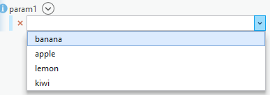

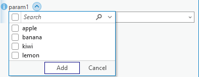

However, in an ATBX, you get this:
Interestingly enough, the dropdown is in the correct order, but the "add multiple" is not.
Honestly, I recommend writing in a Python Toolbox anyway. It's a little bit different at the very beginning, but it gives you a lot more control over your stuff, and apparently the implementation of various parameter types in the UI is different.
