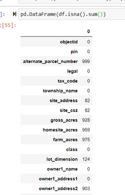

I like using the Python API. Mostly because I learned pandas long before I ever touched arcpy, but I find it to be simple and effective. Using a geodatabase, you'll need to be using the Python API in an environment where arcpy is available to you.
Granted, this snipped is pretty much only for the null counts. The Python API can pull out the other details of published services, but for file-based geodatabases, arcpy's the way to get the rest of the details. But I figured I'd throw another idea out there, in case it's helpful.
from arcgis.features import GeoAccessor
import pandas as pd
df = GeoAccessor.from_featureclass('path/to/database.gdb/layername')
pd.DataFrame(df.isna().sum())
