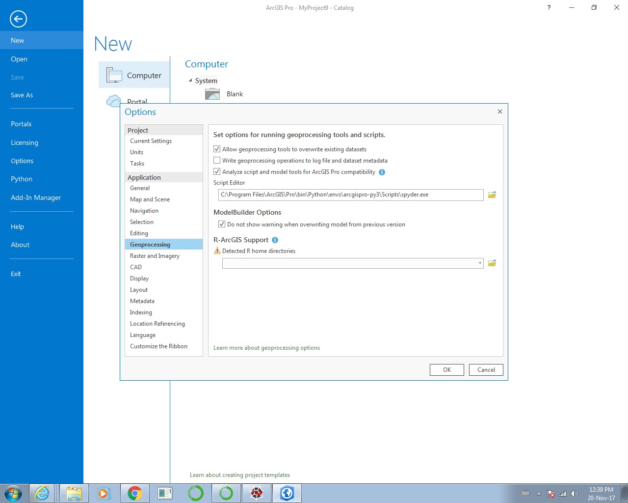

I have those settings in ArcGIS-Pro:

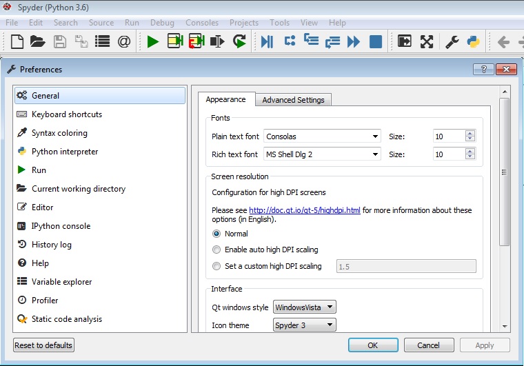

But I don't know, which settings I have to do in Spyder:

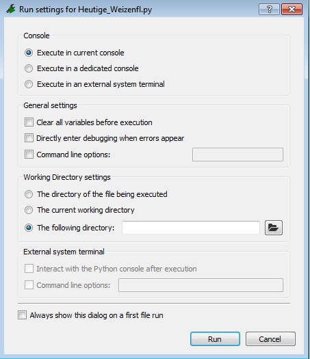

And when I try to run the script. Spyder asks me for settings. I think this is new:

It look fine... see this blog post for the default installation location....

Thanks for your answer.
 - I installed Spyder 2.3.8 Packages in ArcGIS Pro and made the Settings like above
- Than I installed the Spyder 2.3.8 Package in Anaconda
- Than I Launched Spyder from anaconda and wrote my script.
- Than I wanted I wanted to run it. It worked before but suddenly it didn't anymore. So I reinstall Spyder in ArcGIS and Anaconda. Still broken
