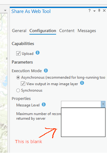

One oddity is that we can't seem to select a Message Level when using the "Share As Web Tool", here's a snapshot - the dropdown is simply blank, maybe it's a clue for someone out there as to why our simple geoprocessing services won't run:

Nothing yet.  Does anyone from ESRI (or anyone) have any ideas as to why this dropdown would not get populated? i.e. what is not talking to what in our Enterprise system? could it be a permissions issue with Server, or a security issue with Portal? I think if we could find the root cause of this little oddity our geoprocessing services might work again.
