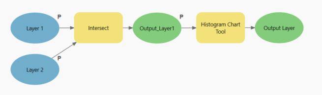

Failing Model example (simplified):

JJH
Thank you for the reply. The output is derived from the input layer in the parameters. I am hoping to not have to use a second model builder tool, I need to be able to apply the charts output within the same model that the layer is created.
JJH
Update: So far, the only partial solution I have identified is hardcoding the predetermined output string name from the models as the input layer name into the code. This makes it so these models can only run with predetermined feature layers, but it does run successfully within the same model.
