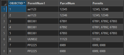

Does it matter if the Permits field is populated for all rows?  Ex:
If not, you could do something like below:

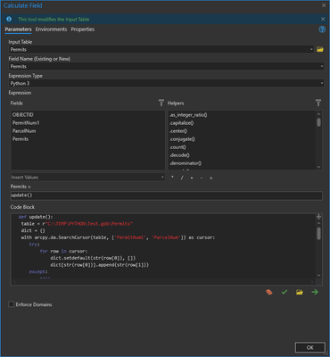

You can add this logic to the Calculate Field tool:
Or you can add a script to a model:
