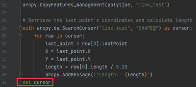

Sorry for the delay. I did test it and it does work but for only the first time. If I need to run the script tool again I get the error - line 35, in <module>
RuntimeError: Cannot acquire a lock.
Are you able to run the script tool multiple times?
JakeSkinner
Esri Esteemed Contributor
@TonyAlmeida, yes, I can execute the tool multiple times.  Try adding del cursor below the SearchCursor:
TonyAlmeida
MVP Regular Contributor
It's working now, thank you for the help!
