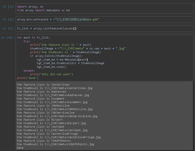

Just tried on my other box with Pro 3.0.3 on it, and ran in a Notebook.  Seems to be working as expected.
I did add a check to make sure the jpg is there before adding it, as if not, it will fail at some point, and have to re-copy all the jpegs again to run.

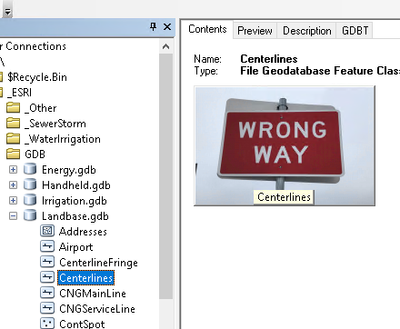

Not sure where/how you are looking at the Thumbnails, but good old Catalog shows them as all being updated:
