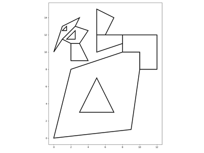

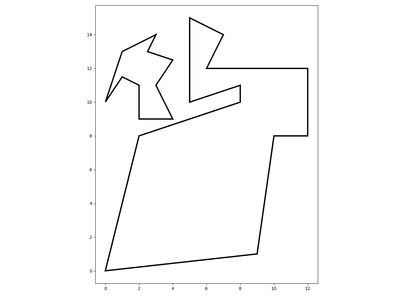

DanPatterson
MVP Esteemed Contributor
merge and dissolve are different processes, with the latter removing shared boundaries in polygons as in the "bird on dog" images below.
yes it can be done, but your image doesn't open

DanPatterson
To dissolve in arcmap/pro, you need a common attribute to dissolve on.  You could add a field with a common value if you don't have one, first and use it as the dissolve field.  You then follow this up with a union to produce a multipart polygon.
The example I have shown is for my own geometry constructor which does it without those requirements.  I will blog about it soon when I am done testing and it will be available then.  In the interim, use the process as describe above
