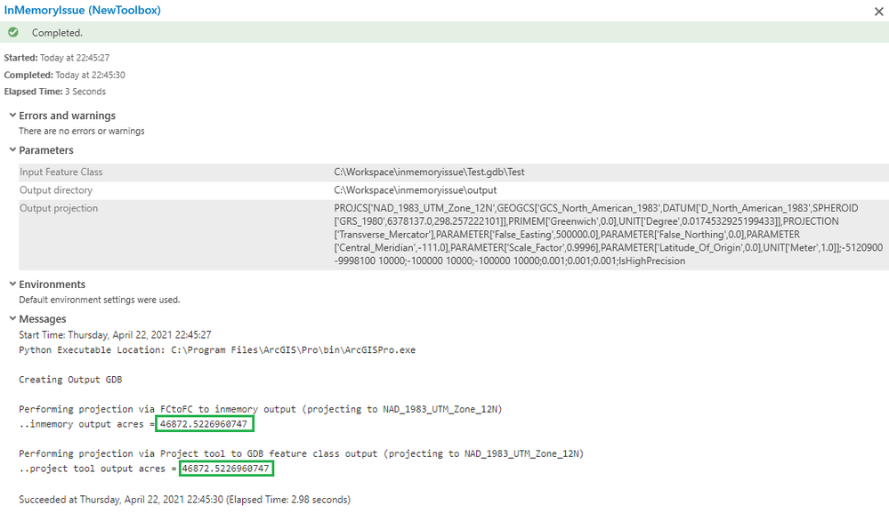

Maybe these screenshots will help explain what I'm experiencing.
The first screenshot shows the calculated geometry values I get when running from the Python terminal, and from script tool when ArcGIS Pro is first opened (no map inserted). The values do not match.
The second screenshot shows the calculated geometry values I get when running from script tool when a map is inserted, and the map frame's coordinate system is changed to NAD83. The values match.
