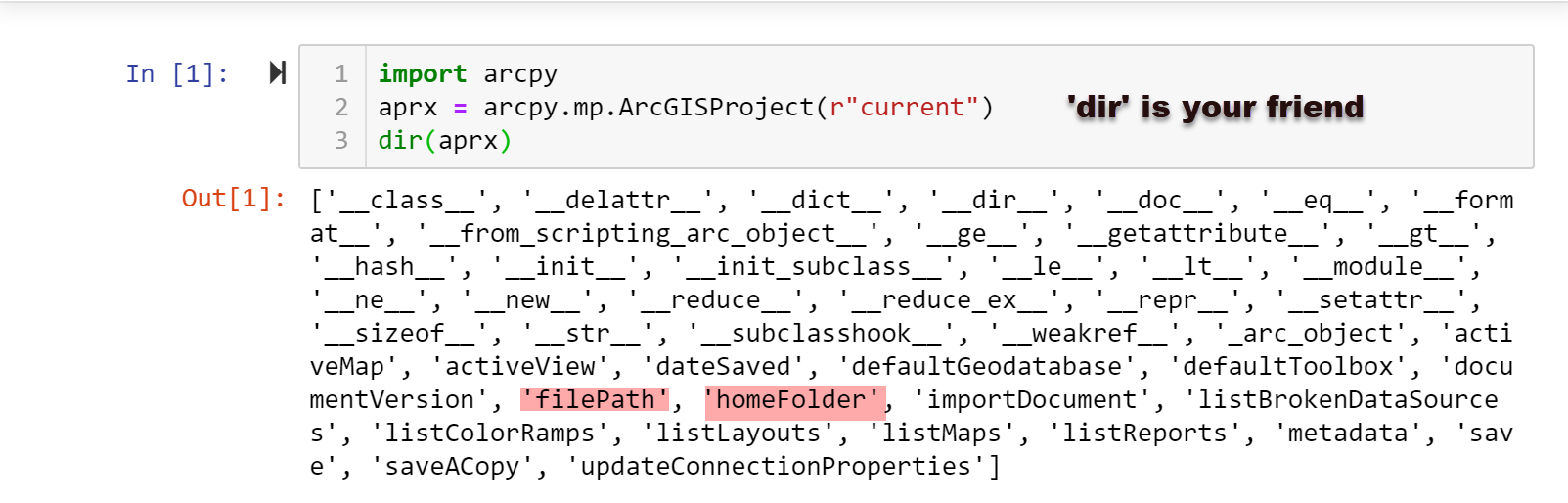

ArcGIS Pro has it... you can even open a Jupyter Notebook in your project for quick testing and 'dir' away on objects to find out what they have.
Pro has some nifty features... don't know if they are available in arcmap

Then add these lines to your script and devolve the project path relative to the running script in the toolbox.
import sys
script = sys.argv[0]
Then you can find the location of the script and if your project is located 'relative' to it, you should be able to construct the project name and location.
script
'C:\\Git_Dan\\npgeom\\_load_sample_.py'
