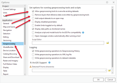

You say the map you currently have open, so I'm assuming you are running this from inside Pro?
If so, perhaps it's the geoprocessing options set in Options page:
You might try with variations of the above settings.  The setting I have here will overwrite the layer if one with the same name is in the active map.

Playing with these options seems to have fixed it for me momentarily but it's still removing layers for some reason now and I haven't sussed out where some setting is getting reset that layer object creation is removing the existing layer again.  My other scripts *want* to overwrite an existing layer on the active map which I'm ok with, so I don't want to toggle it off.
I guess what confuses me is why is the existing layer being touched at all? I'm not passing it as a reference when creating the new feature layer and I'm creating the new feature layer with a different name. The answers in this thread asking a similar question  say I can just pass the URL instead of a layer object so I'm lead to believe Pro is somehow using the URL to grab the first related layer on the active map and overwriting it prior to adding it to the new map (as the error returned from the code would suggest when I turn off "allow geoprocessing tools to overwrite."
