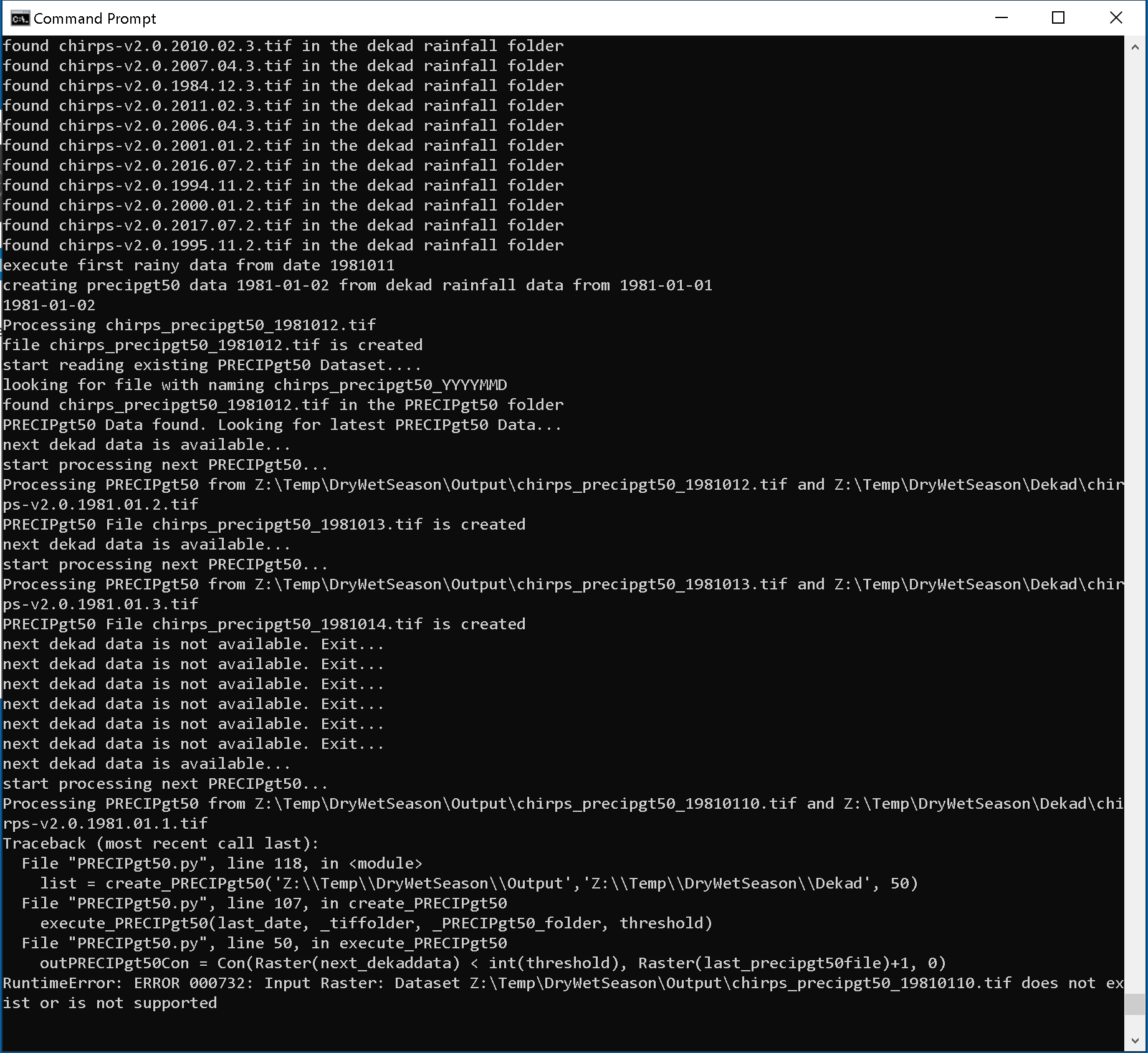

I got an error because the script try to read based on Date information, after finished process chirps-v2.0.1981.01.03.tif the scipt will continue to find chirps-v2.0.1981.01.04.tif and couldn't find the data then error.
Any reference or example on how to make it work?
Below is the error, script and few example of the data (subset from area with smaller size).
Error
found chirps-v2.0.2001.01.2.tif in the dekad rainfall folder
found chirps-v2.0.2016.07.2.tif in the dekad rainfall folder
found chirps-v2.0.1994.11.2.tif in the dekad rainfall folder
found chirps-v2.0.2000.01.2.tif in the dekad rainfall folder
found chirps-v2.0.2017.07.2.tif in the dekad rainfall folder
found chirps-v2.0.1995.11.2.tif in the dekad rainfall folder
execute first rainy data from date 1981011
creating precipgt50 data 1981-01-02 from dekad rainfall data from 1981-01-01
1981-01-02
Processing chirps_precipgt50_1981012.tif
file chirps_precipgt50_1981012.tif is created
start reading existing PRECIPgt50 Dataset....
looking for file with naming chirps_precipgt50_YYYYMMD
found chirps_precipgt50_1981012.tif in the PRECIPgt50 folder
PRECIPgt50 Data found. Looking for latest PRECIPgt50 Data...
next dekad data is available...
start processing next PRECIPgt50...
Processing PRECIPgt50 from Z:\Temp\DryWetSeason\Output\chirps_precipgt50_1981012.tif and Z:\Temp\DryWetSeason\Dekad\chirps-v2.0.1981.01.2.tif
PRECIPgt50 File chirps_precipgt50_1981013.tif is created
Processing PRECIPgt50 from Z:\Temp\DryWetSeason\Output\chirps_precipgt50_1981013.tif and Z:\Temp\DryWetSeason\Dekad\chirps-v2.0.1981.01.3.tif
PRECIPgt50 File chirps_precipgt50_1981014.tif is created
next dekad data is not available. Exit...
Processing PRECIPgt50 from Z:\Temp\DryWetSeason\Output\chirps_precipgt50_19810110.tif and Z:\Temp\DryWetSeason\Dekad\chirps-v2.0.1981.01.1.tif
File "PRECIPgt50.py", line 118, in <module>
list = create_PRECIPgt50('Z:\\Temp\\DryWetSeason\\Output','Z:\\Temp\\DryWetSeason\\Dekad', 50)
File "PRECIPgt50.py", line 107, in create_PRECIPgt50
execute_PRECIPgt50(last_date, _tiffolder, _PRECIPgt50_folder, threshold)
File "PRECIPgt50.py", line 50, in execute_PRECIPgt50
outPRECIPgt50Con = Con(Raster(next_dekaddata) < int(threshold), Raster(last_precipgt50file)+1, 0)
RuntimeError: ERROR 000732: Input Raster: Dataset Z:\Temp\DryWetSeason\Output\chirps_precipgt50_19810110.tif does not exist or is not supported

BennyIstanto
Hi Dan, thanks. I have updated my question and include a screenshot from cmd window.

DanPatterson
MVP Esteemed Contributor
The print statement is cutoff in the screen grab
Anyways
Z:\Temp\DryWetSeason>
Error: 000732: Dataset does not exist or is not supported
and its causes.
The root is whether the input raster exists.  You should confirm it ... arcpy.Exists ... prior to continuing

punctuation in filenames ( .  and -) can cause issues.  Did the previous useage of the script follow that naming convention?
The root error exists on that line, so you will have to check what goes into the line to see if it exists and if it is a tif, it should be going to a folder with the *.tif extension on the next line.
... sort of retired...
BennyIstanto
Yes, the previous script to calculate consecutive dry days works well using Daily data with similar naming convention
chirps-v2.0.1981.01.01.tif
chirps-v2.0.1981.01.02.tif
chirps-v2.0.2020.05.31.tif
punctuation in filenames already eliminated in line 80. I think the problem because the script read input file with date YYYYMMDD information, and the input is just YYYYMMD => the D is not Date but Dekad with value 1, 2 and 3.
I dont know how to modified that
