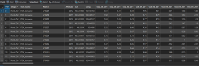

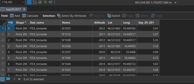

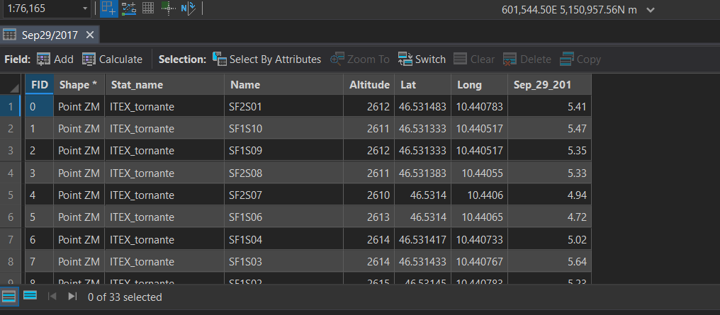

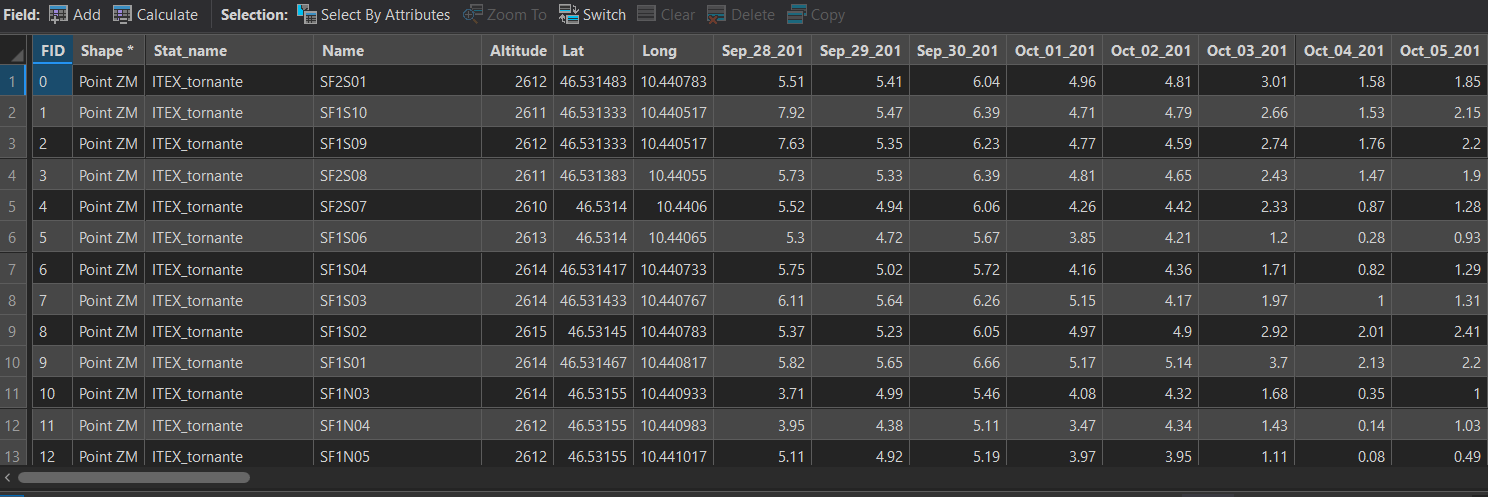

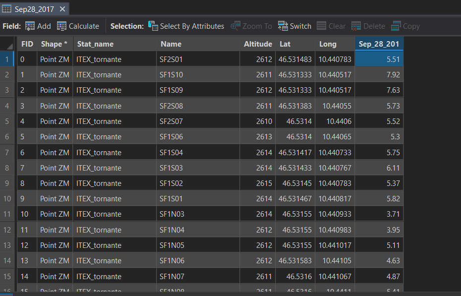

Here is one example using an image
This is the csv file converted to shapefile with all the dates
Converted shapefile I want
