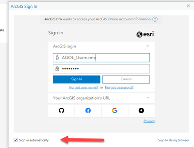

I installed Pro on the server machine,  logged onto the server machine with the service account, logged into Pro with appropriate user, and select the Sign in automatically option.  This stores the credential so that it automatically logs me in with the last used credentials.
The scheduled tasks will then also use this last logged in credentials to run the python script(s).  However, there is a time out on this, I believe it is two weeks.  So, if it's been too long since the appropriate user has logged onto Pro manually (or if a different user has logged on in between), it will fail.  (So, we don't allow 'other' users to run Pro on the server machine)
My workaround for this is to run a scheduled task every week that opens Pro, pauses a few seconds, then closes Pro.  This keeps the credentials up to date and keeps my scheduled tasks running.

I don't 'log out', just close Pro.
As long as the Sign in automatically was checked last login, and didn't log out, it works.
Do you not see the Sign in automatically checkbox?
R_
LondonWalker
Yes, we have clicked that checkbox. It does not stay signed in. On my desktop if I close out of pro and reopen I am still logged in. It doesn't work on my server machine, no matter if the checkbox is checked
