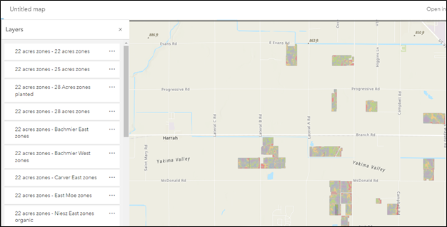

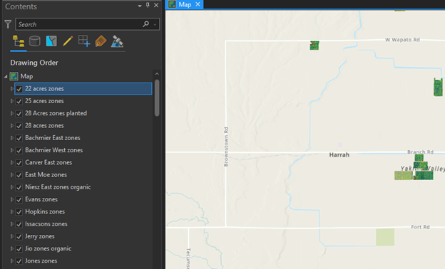

I have a multitude of layers in an ArcPro map that I want to upload to AGOL using ArcPy.  The following code will upload each layer that includes the name "zone" to a folder in AGOL. However, when I open the layer in AGOL, I see that it actually contains all the data from all other layers too (see screenshots). How can I have the code explicitly reference a single layer in my map?

I have read through the documentation multiple times to try to get a handle on what listLayers does and what it will return.  I need the program to iterate through the layers in my ArcPro doc and publish them separately, which is not really happening. From the documentation, the listLayers gives an object at a location, as shown below.
Using the code I first posted, I can get it to list the names using the filter criteria, but when the layer gets published, it actually publishes the data from all layers under that one name, and this repeats for each layer. The second picture in the original post shows the layer "22 acres zones - XXX zones" in a web map. This layer contains the geometry and name of all other fields under the heading of "22 acres zones". This is where I get confused about what exactly I am calling and how the data is being read to be published.
