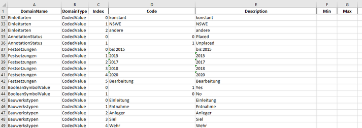

# instead of a DataFrame, define your data as a simple twodimensional list
rows = []
column_names = ["DomainName", "DomainType", "Index", "Code", "Description", "Min", "Max"]
# fill the list
for domain in domains:
    if domain.domainType == "Range":
        row = [domain.name, domain.domainType, 0, None, None, domain.range[0], domain.range[1]]
        rows.append(row)
    else:
        for i, (k, v) in enumerate(domain.codedValues.items()):
            row = [domain.name, domain.domainType, i, k, v, None, None]
            rows.append(row)
# convert to DataFrame
dataframe = pd.DataFrame(rows, columns=column_names)
# export
dataframe.to_csv("N:/folder/domains.csv", index=False)
dataframe.to_excel("N:/folder/domains.xlsx", index=False)
Have a great day!
Johannes

import arcpy
import csv
gdb = r"path\to\geodatabase.sde"
csv_filepath = r"path\to\export.csv"
domains = arcpy.da.ListDomains(gdb)
with open(csv_filepath, 'w', newline="") as csv_file:
    writer = csv.writer(csv_file)
    ## write the header
    writer.writerow(["DOMAIN_NAME", "DOMAIN_TYPE", "CODE/MIN", "DESCRIPTION/MAX"])
        print(domain.name)
        if domain.domainType == 'CodedValue':
            coded_values = domain.codedValues
            for val, desc in coded_values.items():
                print('\t{0} : {1}'.format(val, desc))
                writer.writerow((domain.name,"Coded", val, desc))
        else:
            range_min = domain.range[0]
            range_max = domain.range[1]
            print("\t", range_min, range_max)
            writer.writerow((domain.name,"Range", range_min, range_max))
~ learn.finaldraftmapping.com

Jen_Zumbado-Hannibal
Thank you @JohannesLindner and @Clubdebambos  for your help. It worked perfectly!
I just have to remember to import csv module too 😉
