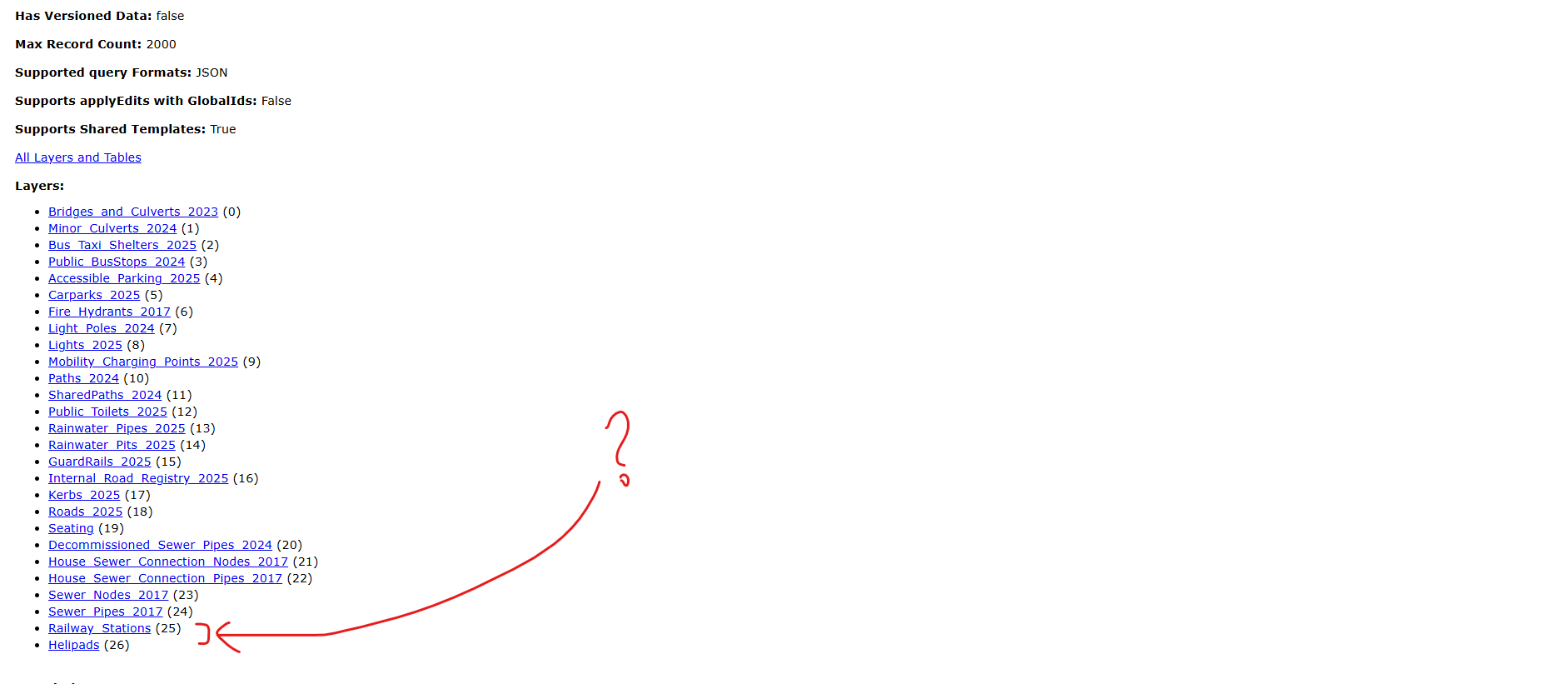

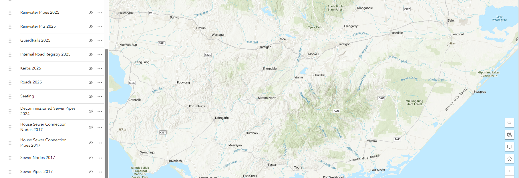

Hey guys! I was tinkering around with python to try and automate updates of certain layers to ArcGIS online and I've run into something quite strange. I was hoping it someone else also ran into this issue.
After my code runs to update a hosted feature layer, I see that any additional layers I add to the ArcGIS pro map doesn't seem to be reflected in the hosted feature layer even though the code does say it was successful in overwriting the layer and the SD file? What's even more strange is that the new layers do show up in the REST end point but not in the actual feature layer or Map Viewer or even when I open that layer into ArcGIS using the portal.
(No the layers are not out of order or anything)
Has anyone else come across this issue?
I've provided a few photos to this post. And here's a snippet of the code:

JordanCarmona
You have to use the AGO assistant to update the webmap JSON: https://ago-assistant.esri.com/
It's cool, but kind of a pain. You may be able to interact with it programmatically but you'd need to see the diff. So you'd probably need to publish clean, check out that JSON, then diff it to the existing.
