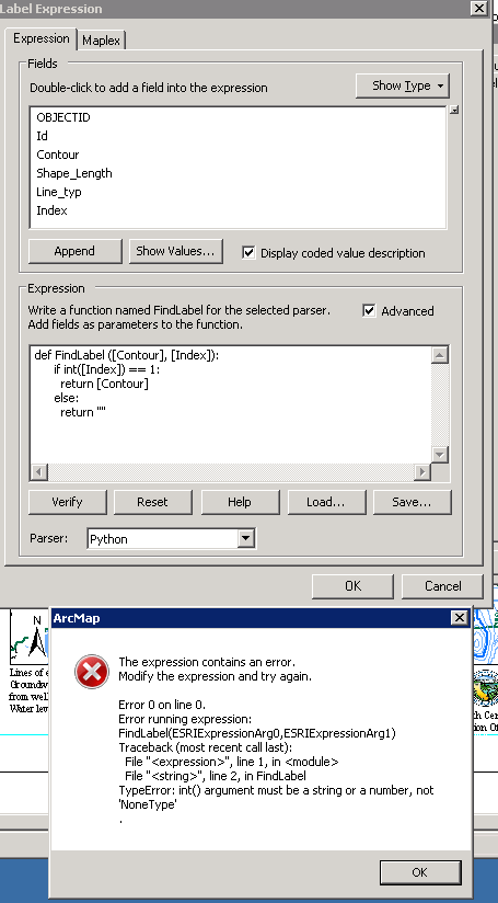

I copied both of these scripts and I still am getting an error! here is a screen shot of the script and error:
I guess the previous people who were trying to help in what I thought was Python, were giving me the VB script!
Why does this still not work?
RichardFairhurst
MVP Alum
It does not work because Index contains Null values and Null values cannot be converted to Int.  So you need to handle Null values (VB Script would throw the same error).

I think I figured it out....The index field that has 1's for what I want to label had <NULL> as the value for the one's I do not want to label. Once I changed that to a 0 it labeled them like I wanted.
