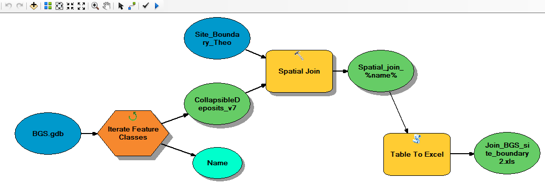

Hello,
My task is:
1. Spatial Join multiple features to a Site_Boundary polygon feature
2. Export the output file to a single Excel document containing the target layer and all joining layers.
So far here is my model:
BGS.gdb is where the joining features are located (polygons and lines).
I spatially join each feature to my target feature (Site_Boundary_Theo) using Iterate Feature Classes.
The output is given the name Spatial_join_%name%.
This output is exported to an Excel file.
The spatial join creates multiple Site_Boundary feature classes (with the name of the joining feature appended to the file name):
The output Excel file only contains data from one of these feature classes:
In this case, the Excel file is the Site Boundary attribute table with the BGS_Linear_50K attribtues joined.
My question is, how can I create a single Excel file showing the target layer with ALL the joining layers?

DarrenWiens2
MVP Alum
You only get one Excel file with the results from the last iteration because the whole model runs on each iteration, overwriting the final Excel file each time. You could get multiple Excel files if you varied the file name like you did with the Spatial Join output. Or, you could get a single output in the end by using Collect Values and merging the results before exporting to Excel. It probably won't be the exact result you're looking for, but that's the trade-off using model builder rather than Python...
