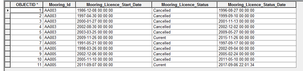

Shown below is a subset of my data. How do I iterate through based on the mooring ID? What I want to happen is do something for mooring ID AA003 then skip to mooring ID AA005 and do the process again. I am aware of search cursors but this processes each row. In this example I want the process to run twice, not each time for the 11 records.
What I am ultimately wanting to do is nest my process within what I am trying to do above. That is, grab the first of the series of mooring IDs, run the nested process, then move on to the first of the next series of mooring IDs and run the nested process again.
I have tried to create a separate list without success. I have tried to use arcpy Statistical analysis but this resulted in a table with a single record detailing the number of occurrences of the mooring ID (in this case AA003). Is there a way of creating a summary table of mooring_Id.First? This would give me a list of unique mooring ID's (in this case; AA003, AA005). Though this may be one way of doing it I would prefer just to run the process for the first of each mooring IDs.

DaveMarkey
Regular Contributor
Thanks all for your replies. Unfortunately I cannot get my head around python groupby - though I have an understanding of what it is attempting to do. To clarify things I have added my extra code below. What I am wanting to do is compare the licence start date of the last cancelled licence with the start date of the current licence for each mooring ID. I have found there are data errors in our licencing database. Some moorings have a cancelled licence with a more recent start date than that of the current licence. The print component at the end will be replaced with a statement to output to a list the mooring IDs with a cancelled licence start date that is more recent than that of the current licence. Apologies for my crude scripting as I am very much a novice at this.

Just checked with a date field in a feature class. When you read it in using arcpy.da.SearchCursor it looks like a datetime.datetime style date/time.
ie it looks like this :
>>> n1 = datetime.datetime.now()
>>> n1
datetime.datetime(2018, 9, 12, 13, 49, 33, 458000)
And you can compare these directly.
So, lets go with 1 dict for the whole table with fields of oid, mooringId, startdate, status
Use Joshuas idea of constructing a dict with a list of oids per mooringId.
See example below. I am sure the other contributors can think of some more elegant way.
