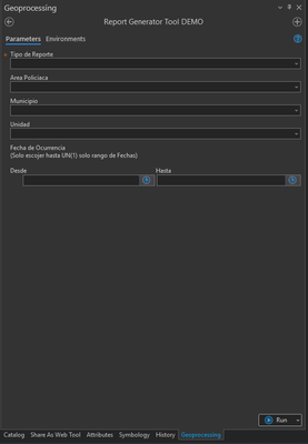

Hi all! I developed a python toolbox for ArcGIS Pro (.pyt) which contains a tool that will generate one of three reports. The tool is supposed to perform queries, process the queried data and finally generate the report selected by the user. This tool has several optional parameters that can be selected by the user but only one required parameter - Report Type.

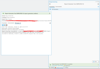

When I run this tool in ArcGIS pro, all three possible reports are generated successfully, and the tool returns the path to the generated file as output, no problems there.

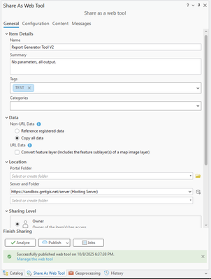

My issues arise once I publish this tool as a Geoprocessing Service. To publish the tool, I right click on one of the successful runs from the history tab, and select Share As > Share Web Tool. I fill out the relevant information, analyze then publish.

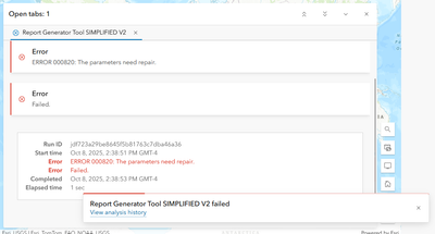

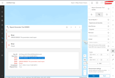

The tool gets published successfully. Once I try to execute the published tool (In my case, I'm trying it from the map viewer) I'm getting an error message saying "ERROR 000820: The parameters need repair." -  which is weird because the tool was ran in ArcGIS Pro, then published, so I'd think if there were any problems with the parameters, it should have raise errors prior to this point. Server Manager logs are not helpful either.
Originally I tried publishing this tool from ArcGIS Pro 3.5.2. When I did I got the error message "The tool Is not valid." I asked around the office and a coworker mentioned I should try publishing the tool from an earlier version, since the version of ArcGIS Enterprise where the tool being published to is 11.3. I started getting the "Parameter needs repair" message when I downgraded and published from ArcGIS Pro 3.4.2, and when downgraded and published again from ArcGIS Pro 3.3.7.
Finally and worth mentinong, this script makes use of the python-docx library, which I installed both in my local machine AND in the server where the tool gets published to. (Clone python environment, activate cloned environment, pip install python-docx)
Attached to this post I include a shortened version of the tool I'm trying to use once published. I have omitted all queries normally performed by this tool and have focused the code to just generate the report(s).
Any information that may help me troubleshoot this issue is greatly appreciated, thanks!

UPDATE: I made a version of this tool that DOES NOT use any libraries not included in the default ArcGIS Pro interpreter, however the problems mentioned in the previous post persist.
Only one of the reports is available to be generated in this example, FYI.

Hello, thank you for your quick reply and suggestion! I have published a new tool with the following source code. I have removed all parameters except the output parameter and made the output a simple string. After publishing the geoprocessing tool I have restarted the server (Now using a single machine installation to do my tests) in order to clear the cache as suggested. I'm still having the same issue where once published and executed, I get the error saying that the parameter needs repair 🫠

        out_file = self.report_generator("", "Relaciones de Eventos")
        if(out_file):
            parameters[0].value = out_file
        return
