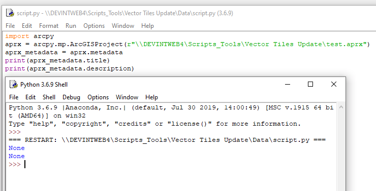

But when running outside of ArcGIS Pro it is not getting the metadata e.g.
This is using ArcGIS Pro 2.5.1. It seems to be okay for metadata on datasets, but not for projects, layers and maps from my testing. I'm not sure if this is a bug or if there is something else I need to be doing when executing the code outside of ArcGIS Pro?
