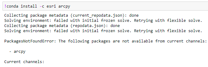

2) If anyone could share how to install arcpy to Jupyter via Jupyter? I've uploaded arcpy  (which I downloaded here: https://anaconda.org/Esri/arcpy) and unzipped it, but nothing seems to be working. The following errors occur when I try to install using conda. If I could get it installed I could potentially use virtualenv to build an environment with compatible packages, but am hopeful that someone has a simpler solution. (Aside from not using Arc, which is what my CS prof is voting for, but I have a whole workflow in ArcPro that I'd love to be able to use.)

A little Windows Explorer will lead you to the toolbox location
C:\..your_install_folder..\Resources\ArcToolBox\toolboxes\Space Time Pattern Mining Tools.tbx
import arcpy
is common, and when you import arcpy a valid license for arcgis pro is checked on the local machine (in the case of local machine install... principle is the same for other situations)
The scripts are located in the...
C:\..your_install_folder..\Resources\ArcToolBox\Scripts
So arcpy is needed.. just have a look at SSCube.py
Arcpy can be installed but it has python requirements and environment requirements, which you can explore on your local machine.  So skipping arcpy is not in the plan at least which narrows your possible options.
