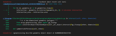

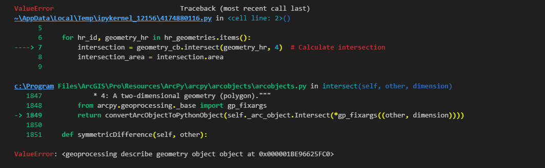

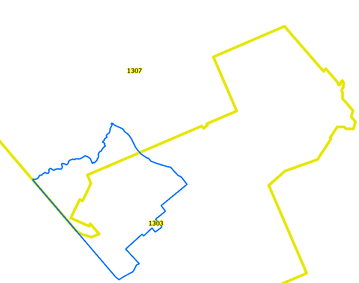

Im trying to determine if 1307 or 1303 occupies more of the blue polygon. I need to do this for a series of polygons and want to automate this step this using python.
for c_id, geometry_c in c_geometries.items():
    largest_intersection_h_id = None
    largest_intersection_area = 0
    for h_id, geometry_h in h_geometries.items():
        intersection = geometry_c.intersect(geometry_h, 4)
        intersection_area = intersection.area
        if intersection_area > largest_intersection_area:
            largest_intersection_area = intersection_area
            largest_intersection_h_id = h_id
    if largest_intersection_h_id is not None:
        c_h_dict[c_id] = largest_intersection_h_id
for c_id, h_id in c_h_dict.items():
    print(c_id, h_id)
 I get this error message when I try this code
