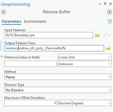

Memory just works as if you were putting that file in a folder called memory.
arcpy.analysis.PairwiseBuffer(
    in_features=r"\\...\RLFO Boundary.lyrx",
    out_feature_class=r"memory\admu_ofc_poly__PairwiseBuffe",
    buffer_distance_or_field="10 Meters",
    dissolve_option="NONE",
    dissolve_field=None,
    method="GEODESIC",
    max_deviation="0 DecimalDegrees"
When I use it, it's typically like
    method="GEODESIC",
