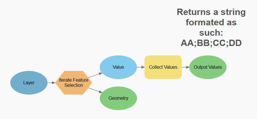

DuncanHornby
MVP Notable Contributor
Collects Values tool will return a string of semicolon separated values such as AA;BB;CC;DD.
It is up to you to split this string and process as you wish.
Example:
DuncanHornby
Example:
Poncio
Works perfectly! Thanks 😄
