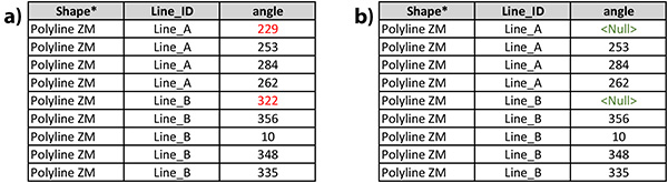

I'm trying to find a way of adding <Null> to a record when there a change in the data sequence on another field attribute...?
I've been trying to adapt this code to achieve this, but I'm struggling.

The result should be something like this:
I'm rather new to UpdateCurser, so, generally don't know how it works.

Does this work for you?
import arcpy
from arcpy import da
vertices = "dataset"
#set firstRow variable to true
firstRow = True
with arcpy.da.UpdateCursor(
    vertices,
    ["Line_ID", "angle"]
    sql_clause=(None, "ORDER BY LINE_ID, OBJECTID")
) as cursor:
    lid_prev, ang_prev = next(cursor)
    cursor.updateRow([lid_prev, None])
    for lid, ang in cursor:
        if lid != lid_prev:
            cursor.updateRow([lid, None])
        lid_prev = lid

CliveCartwright
Much appreciated Joshua. Thank You.
