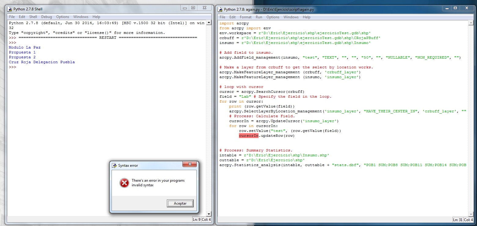

I 'm trying to run my script but I get this error message.
Here is the code.

Extra bracket in 23.   row.setValue("test", (row.getValue(field))
Change it to: row.setValue("test", row.getValue(field))
Also, consider using arcpy.da.Search/InsertCursor instead of arcpy.Search/InsertCursor, the new (at 10.1) cursors are much faster and have easier and more "pythonic" syntax.

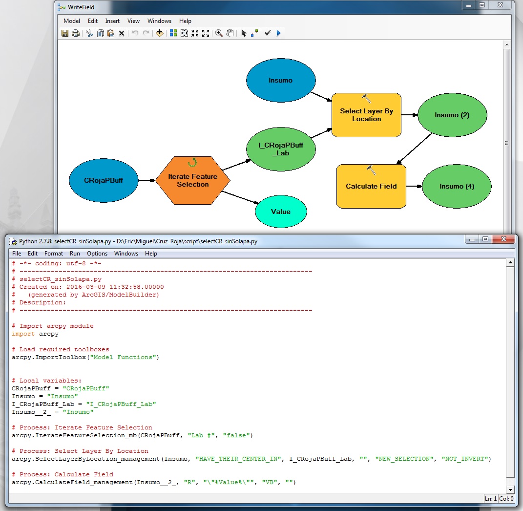

I'm trying to write in "test" field from insumo layer the value field from the select by location features loop of crbuff layer.
G__EricCastillo_Morales
I'm trying to write in test field from some layer based on iterate feature selction. I get succes using model builder but I'm fail when I try with my own code.
The process with MB.
The code and error.
Any suggestions?
