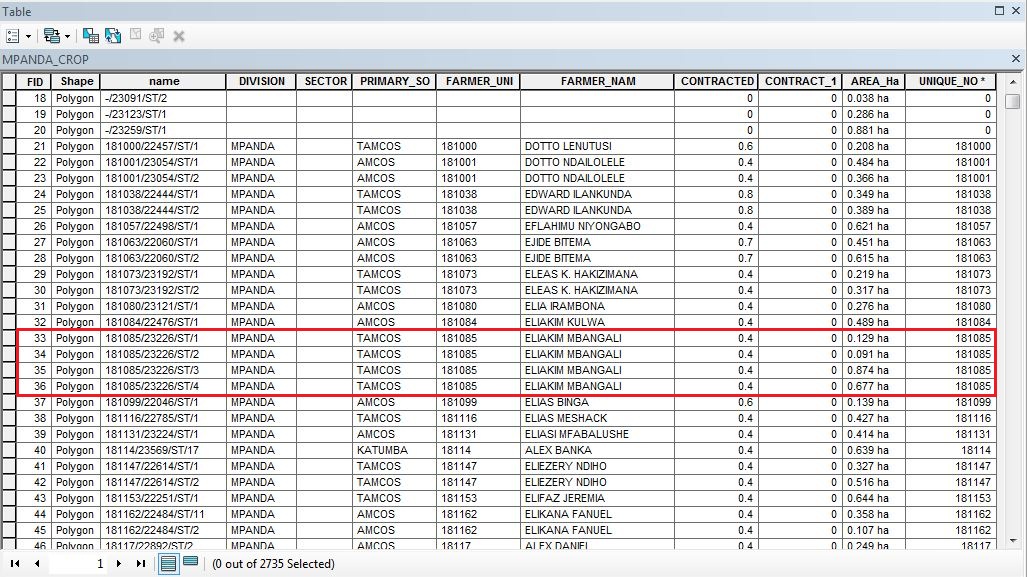

I want to add a column in my dbase file which will have geometry data (Area)  by joining the dbase file with attribute table.
I have tried to use "FARMER_UNI" from my dbase file to join with "FARMER_UNI" from my attribute table, but the result were not what i wanted.below is an attribute table,

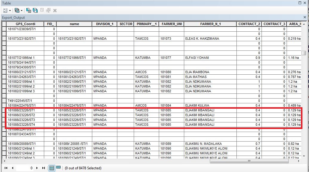

And here is the results i get,
So what i want is the "name" field to be the same as "GPS_Coordi" field, but i cant use those field to do the joining without doing some changes because there is some spelling error such as removing the middle values(12345/6578/ST/1), adding "/" after ST, changing the lower case to upper case(st to ST), and removing spaces between values.
I think you have answered you own question with
     "but i cant use those field to do the joining without doing some changes because there is some spelling error such as removing the middle"
Since those are basically the common unique field, but with slightly different formatting, I would suggest making a new field in each file and formatting or calculating the code to make those equivalent.
Since the "name" field does not always contain a valid GPS coordinate it would be hard to do a spatial join unless you have propery xy coordinate in field that isn't in your graphic, in which case you create an event theme etc. But if you dont, the unique field creation may be your only option.

But what i need now is to create a field both in a Table and dbase file which can have the values of "name" field,without the middle number eg.(181073/ST/1) instead of (181073/23792/ST/1), Also for the cases like 181073/23792/st1,181073/23792/st 1,181073/23792/ST/01 to become 181073/ST/1.
