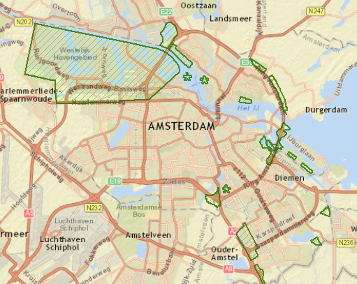

Dear people,
I am a beginner in arcgis, I have problems to an Excel file with a coordinate information (These are the coordinates of a few polygons, see Appendix), how can I visualize these coordinates in ArcMap as a shapefile?,
Is there somebody help me to solve this ?, thx a lot .....
regards, Lion@g

The format you have in column G (COORD) is the WKT format. You can convert these coordinates pretty easy using arcpy (I have truncated the coordinates for readability):
def main():
    import arcpy
    lst = ['POLYGON((4.862563 52.429738,4.862689 52.429747, etc))',
          'MULTIPOLYGON(((4.949747 52.295639,4.949747 52.295551, etc)))',
          'MULTIPOLYGON(((4.875532 52.40248,4.846486 52.385999, etc)))',
          'MULTIPOLYGON(((4.887551 52.406914,4.887522 52.406819, etc)))',
          'MULTIPOLYGON(((4.913632 52.324501,4.912419 52.324293, etc)))',
          'POLYGON((5.017926 52.31812,5.008508 52.320116, etc))',
          'POLYGON((5.009507 52.302302,5.009488 52.302189, etc))',
          'MULTIPOLYGON(((4.977376 52.379963,4.97689 52.37982, etc)))',
          'MULTIPOLYGON(((4.979968 52.369252,4.979748 52.368883, etc)))']
    res = []
    for p in lst:
        polygon = arcpy.FromWKT(p)
        res.append(polygon)
    fc_out = r"C:\Forum\WKT\test01.shp"
    arcpy.CopyFeatures_management(res, fc_out)
if __name__ == '__main__':
    main()
This code just converts the polygons, no attributes are taken over to the shapefile.
After this I run the repair geometry (due to the incorrect order of the coordinates in the rings) and set the coordinate system to WGS1984.
Find attached the shapefile with the (multi)polygons (including a shapefile using RD_New coords).
