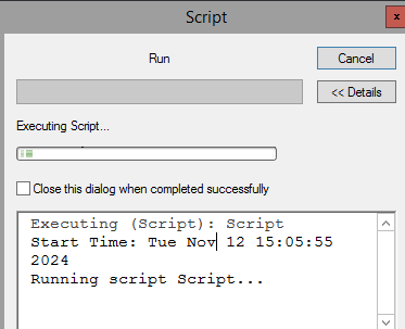

TeresaBartolomei
Same, actually it doesn' get stuck but it never ends executing:
maybe it's because it has no output parameter?
