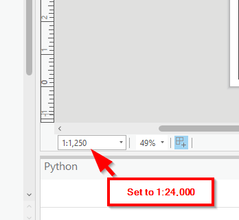

In pro I can't seem to get set
aprx = arcpy.mp.ArcGISProject("CURRENT")
map = aprx.listMaps()[0]
#lyr = map.listLayers("SUBJECT_PROPERTY")[0]
lyt = aprx.listLayouts("Map")[0]
mf = lyt.listElements("MAPFRAME_ELEMENT")[0]
#mf.camera.setExtent(mf.getLayerExtent(lyr, False, True))
ext = map.defaultCamera.getExtent()
mf.camera.scale *= 1.25 #some how set this to 1:24,000

2Quiker
After trying your suggestion but, but after I run the code the zoomed scale changed.
I am curious to see how people, if anyone is getting zoomed scale like in Arcmap with Python.
