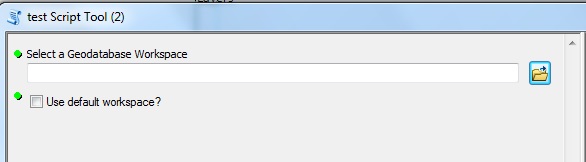

I have a script tool which requires a parameter in the GUI (folder path to a gdB, via GetParameterAsText) so that a later process can be saved there. The thing I want to do is make an Optional Boolean parameter, that when checked, automatically fills in the folder path gdB parameter. The boolean text asks the user, "Use default workspace?", to which if they check the box (boolean == True), then the folder path parameter will be automatically defaulted (saving the user a small amount of time). I have already created the boolean parameter in the script tool, I am however unaware of how to "fill in" the required parameter based on the user's boolean. Thanks in advance for any help/tips!

DarrenWiens2
MVP Alum
As Freddie Gibson says, use tool validation.
def updateParameters(self):
    """Modify the values and properties of parameters before internal
    validation is performed.  This method is called whenever a parameter
    has been changed."""
    if self.params[1].value == True:
        self.params[0].value = arcpy.env.workspace
    return

@ Ian - Thanks for your reply. There's a couple of different reasons for this. Firstly, the tool I'm making is not necessarily for people who are GIS savvy, ergo they may not know where/what their default gdB is, or how to find it. Also, being as how selecting a gdB path is subject to the most recently viewed folder (i.e., when selecting the folder button, it will not necessarily show the defaulted path, but rather the last path accessed), I want a quick and easy way to fill the folder with the default path by clicking the check-box. Lastly, I understand what I'm asking isn't exactly practical, I'm more just curious as to how one would go about doing this. Thanks!

LanceWilson
Deactivated User
Great, thank you very much for the walk-through explanation. Thanks to everyone for helping point me to 'Tool Validation', which I wasn't very familiar with.
