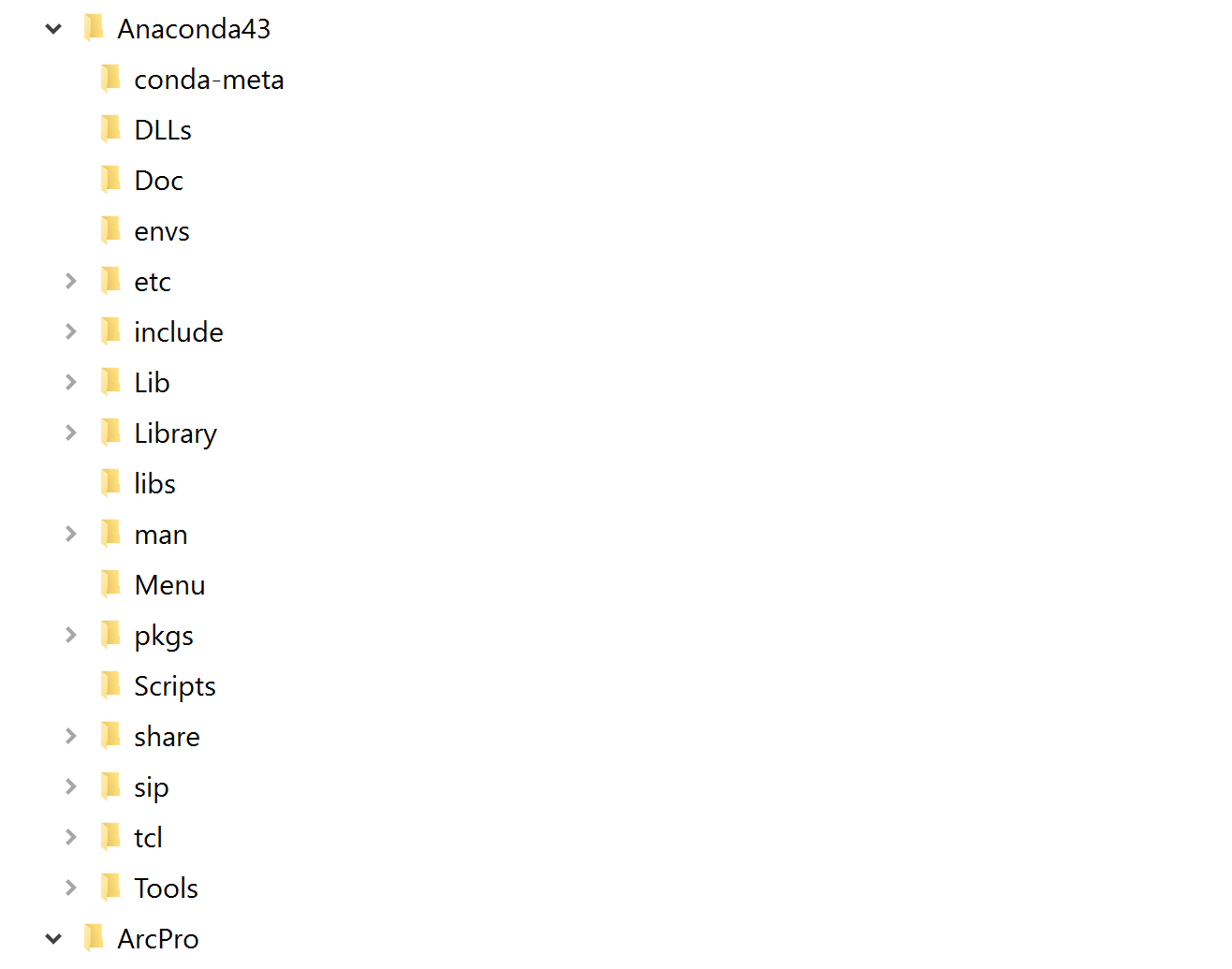

The top of the link was for 1.4.1, the rest as indicated was for legacy installations.
Just install 1.4.1, use their conda distribution, go to my above link images, set yourself up, install your other packages, create desktop shortcuts and you are ready to go.
I keep two distributions... one for non-arc* stuff using python 3.6 as the base, then I let Arc* do its thing and install its own conda distribution.... notice the separation.  I also set up spyder to use as my IDE for both arcmap and PRO.  I also set up a Jupyter QT consol and Pythonwin to run in both as well as Pycharm Edu to kick around on those occasions that I want to prepare lecture materials.  The only thing that I don't use anymore is Pyscripter since development seems to be terminated (open the zip... the dates are two years old) and I read that it doesn't play nice anymore with the conda distribution from arc*.  There is no limits to what you can do.  In the pure Anaconda/python3.6 distribution, I am also using Matplotlib 2.0 which will give you a heads up on what you can do should esri update their package list with future releases.
