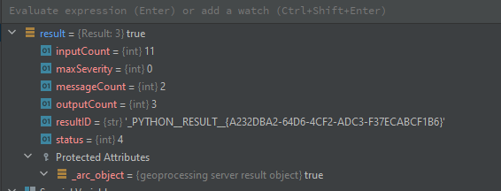

by Anonymous User
Not applicable
Seems that there is a disconnect in the documentation and the tool's derived output.  Looking at the result in the debugger, there isn't any published result. "JSON response containing the service URL and portal item ID of the web layer."
if you use getOutput(2) on the result object, it returns the item id:
msg2 = result.getOutput(2)
'1s71a2emadethisidupea250c748er'
which can be used to create/ reference the item in portal:
https://domain.com/portal/home/item.html?id=msg2
Maybe that is what they meant?  Wouldn't hurt to open a case with esri.
KC
