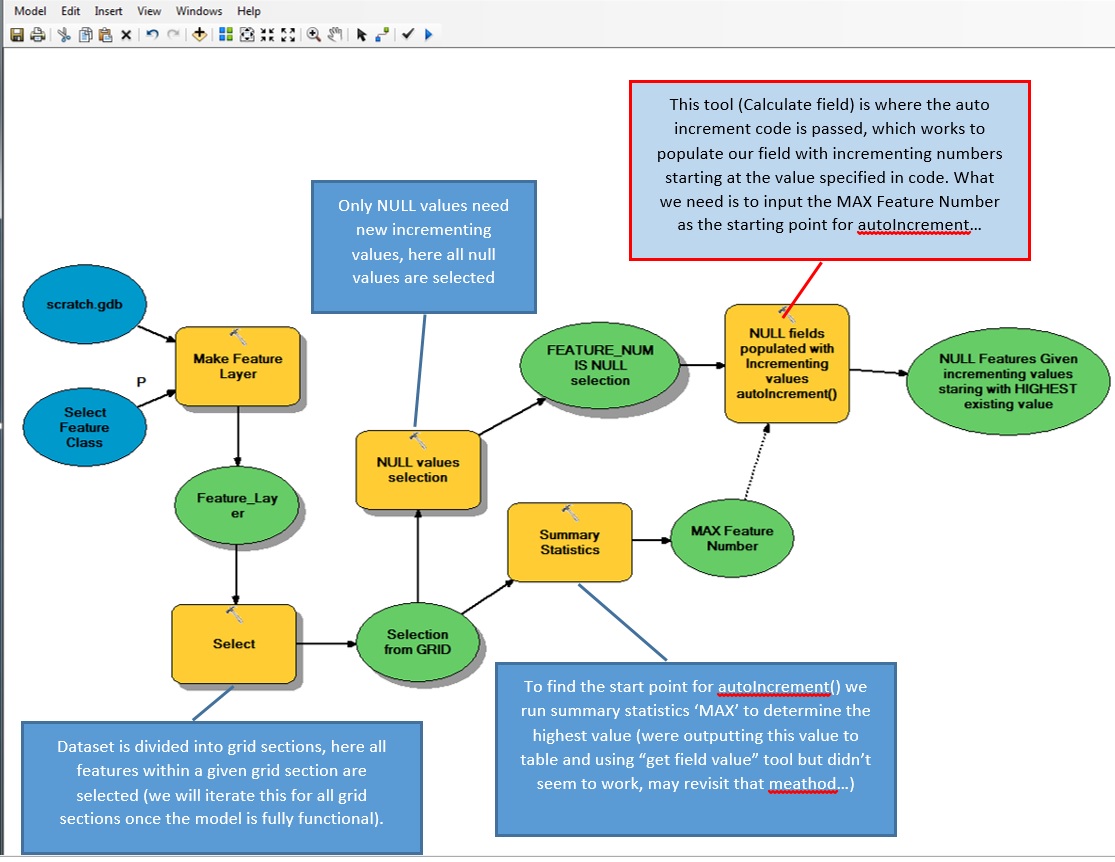

Is it possible to replace the pStart in the code with a variable? In other words I have a value that I need to start from however the code is part of a model and the value may change every time the model is run so I cannot simply replace the "1" with whatever the value is(I have tried this and it works) because the model will be run on many datasets with different values. Here is my logic, I need to pass a value into "pStart =," what I have tried is to define a function and pass that as the pStart value. so that pStart = getfieldvalue then auto increment from this value. I need to replace the "1" with the value that my model has found,  here is my logic that does not work...

Rough working model...
ReedDavis1
After a week of intensive Model Building we have come up with a solution, we did not need to use python except the autoIncrement() function in pre-logic code of our final Calculate Field tool seen in the model. The simple solution was to create a new integer field and populate every record in that field with the MAX value derived from the Summary Statistics tool then use a simple expression: autoIncrement + [MAXvalueField] we then iterate the entire function for every grid block and viola we have an incrementing field starting at the highest pre-existing number. Now that we have our incrementing value we concatenate a new field with that number and our area code(found by a separate model) and we have a unique identifier for every feature in our dataset. The script looks remarkably simple for such a long model...
