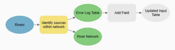

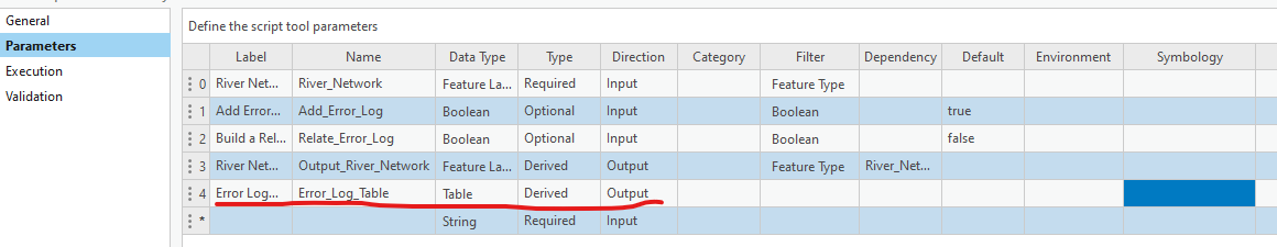

I am developing a suite of python script tools in the ArcPro 3.1.0 toolbox (atbx). A set of these tools create a stand alone table in a file geodatabase whose location is known to the tool.  The user has no control over name or output location, this is controlled in the script itself.  The code runs without error and creates the table as expected. I expose this table created in the script as a derived output as shown below:

When the tool is run straight from the toolbox, all seems to run OK. If I drag 'n' drop it into a model and then link the derived output to say another tool (in the example below it's an add field tool) the linked tool never validates and the model won't run to completion.
I feel its something to do the derived output schema and the Add field tool doesn't know what's linking into it?  There is the schema property of a parameter but all the examples in the help I've been able to find talk about setting the schema of an output that is dependent on an input parameter.  My parameter is populated with a table built entirely within the script.
Does anyone understand what the problem is and can provide any advice? My gut feeling its something that needs to be added to the Validation (ToolValidator code)?  Or are derived parameters meant to be "un-linkable"?

Spurred on by you I did some further searching with Google and finally came across a thread back in 2019 by @NealBanerjee who was having the same issue as me, the output is derived, built completely within the script and essentially is independent to any of the input parameters.
Now I may be wrong but I'm getting the impression one cannot create a derived output and set its schema when the derived output is not dependent on any input parameter.  Unless I'm missing some subtle bit of code I cannot create a derived output and say "this is going to be a table with the following fields"?  The examples in the help file show derived outputs that are dependent upon one of the input parameters.
Clear as mud? 🙂
So unless some ESRI modelbuilder/python scripter guru says otherwise I thinks its not possible?  I'm more than happy to be shot down in flames at this point, if someone could show me otherwise.  I should emphasize I'm developing script tools and not a python toolbox.
Now that all said the thread offered up a solution that is workable, it's a bit of a faff but when I tested it does actually work.  You connect the derived output as a precondition to a Calculate Value tool which simply states what the output type is. Then the Add Field tool validates and the whole model runs correctly.
