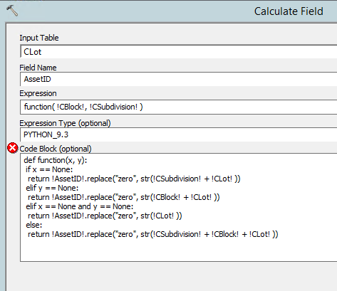

I am trying to put 3 fields together with no spaces and some of them are null. I tried the following expression: !AssetID!.replace("zero", str(!CSubdivision! + !CBlock! + !CLot! ))
If any of the fields are null, then the AssetID field also ends up null. I am trying to find a way around this and this is what I've come up with so far. I get keep getting a parcing error and I don't understand why. Can I return an expression? If not, how would I go about getting rid of the null values without changing my data?
(I'm using 10.4)

If by "put 3 fields together" you mean concatenate three fields with mixed data types, and possibly having NULL values, then try the following in the expression dialog box:
"".join(str(i).strip() for i in (!CSubdivision!, !CBlock!, !CLot!) if i)
