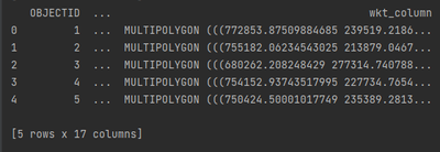

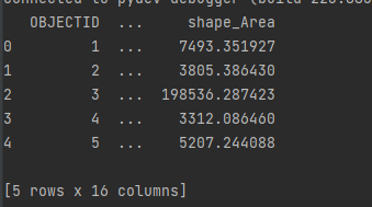

adds the 'wkt_column to the df and sets it to the @WKT value.  In my testing:
before:

but you can also create the column through other ways.
