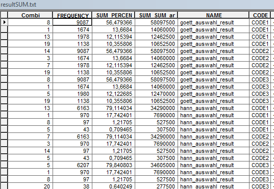

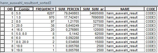

My actual problem is to get the three result tables for one round in the loop to a big one without losing the combinations.
Here is one of the result-tables which should get to the big goal:
At the moment the txt produces a combi-field with the type double but I need a text-field otherwise the combination got lost like here:
So to go back to the opening question I copied your code three times and therefore I got the three combinations. So the question is a kind of answered, I guess there is a faster way. At the moment I don’t know how to get my big table including the combinations. Should I ask this in a new post?

out_folder_path = env.workspace
out_name = "resultfolder"
# Execute CreateFolder
arcpy.CreateFolder_management(out_folder_path, out_name)
newpath= env.workspace + "\\" + out_name
resulttxt = newpath + "\\" + "resultSUM.txt"
f = open (resulttxt, 'w')
f.write ("Combi,FREQUENCY,SUM_PERCEN,SUM_SUM_ar,NAME,CODE,\n")
f.close ()
f = open (resulttxt, 'a')
fc_tables = arcpy.ListTables("*sort_sort*")
for tableR in fc_tables:
    fieldsSe= ["Combi","FREQUENCY" ,"SUM_PERCEN" ,"SUM_SUM_ar", "NAME", "CODE"]
    with arcpy.da.SearchCursor(tableR, fieldsSe, """"OID" < 4""") as sCursor:
        for row in sCursor:
            print row [0], row [1],row [2],row [3],row [4],row [5]
            f.write(str(row[0]) + "," + str(row[1])+ "," +str(row[2]) + "," + str(row[3])+ "," +str(row[4])+ "," +str(row[5]) + "\n")
f.close()

with arcpy.Merge_management I'm able to create the big table.
