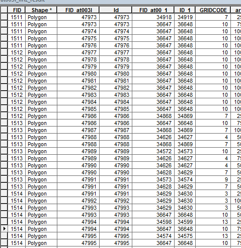

I like to create a new txt which has two columns: Id and GRIDCODE.
This is the original Table:
The Id column of the new txt should have just unique values. I’m able to do this with the following code. But the GRIDCODE -column of the new txt should have the possible combinations of one equal Id, for example:
The new Id field 47973 should have the new GRIDCODE field 7, 10
or the new Id field 47990 should have the new GRIDCODE field 4, 7.
To clarify the question I build an example-table with excel, this should be the result I like to write in the new txt. Do I have to work with an update cursor and if, else? What about the comma, how is it possible to use them without getting a new column but the combination in a column?

The code to get the unique list of ID values and a concatenated list of GRIDCODE values is done with the search cursor outputting to a dictionary.  The dictionary key makes sure that you will get a unique list of ID values,  If you need the values sorted, then the dictionary does not do that unless you put it through a secondary process.

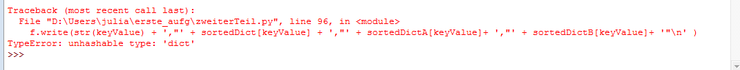

I like to ask you kindly how I can write more than one combination to the new txt.  To make a better analysis I created new classifications and now I like to add there combinations to the txt. Therefore I copied your code two times and filled the new fieldname to the searchcursor and gave new names, the keyValue is always the same. But I have problems with the lines:
    for keyValue in sortedDict:
            f.write(str(keyValue) + ',"' + sortedDict[keyValue] + '"\n' )
    f.close()
I tried this, but it isn’t working.
    for keyValue in [sortedDict, valueDictA, valueDictB]:
            f.write(str(keyValue) + ',"' + sortedDict[keyValue] + ',"' + sortedDictA[keyValue]+ ',"' + sortedDictB[keyValue]+'"\n' )
    f.close()
At the momant I'm doing it 3 times, so not a nice solution... And than joins

The code you wrote makes no sense to me.  I would have to restructure the code from the beginning and not at the stage you have rewritten it to deal with 3 fields.  If this is all coming from one record the code probably can be written using one dictionary.
I need to see an example of the data and the result you really want.  Is this data all in one table?  Are they from separate tables?  Are there Nulls that have to be excluded?
The error is also dependent on the code your wrote that populates the dictionaries.  I also don't think you can write a for loop the way you have written it.  You cannot extract keys from 3 dictionaries at once.  You have to get the keys from just one dictionary at a time and verify they are in the other dictionaries.  Also, the dictionaries in the for statement do not match the dictionaries in the string concatenation statement.
So give me a real example of what the input data would look like and what you want the output to look like for value 47991.
