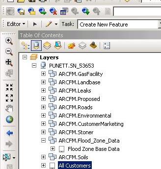

How to connect a argis, sde version through stand alone python script. SDE.Mapping is child version of SDE.Default and I want to make child version of SDE.Mapping . I am using direct sde services, sde:oracle11g:dbname
I need to know command of python to connect to a sde version.
